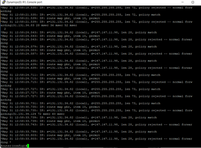

05-31-2022 12:38 AM - edited 05-31-2022 12:39 AM
R1:
access-list 100 permit host 131.131.34.82 host 147.147.11.98
access-list 100 permit host 131.131.34.163 host 147.147.11.98
route-map PBR permit 10
match IP address 100
set IP next-hop 131.131.34.168
IP local policy route-map PBR
R2:
access-list 100 permit host 147.147.11.98 host 131.131.34.163
access-list 100 permit host 147.147.11.98 host 131.131.34.82
set IP next-hop 131.131.34.138
i used the above commands
PBR not working, still i am not able to send packet from r1 to r4 to r5 to r2. (this is the way i need to use)
but it using this way (r1 to r3 to r2)
