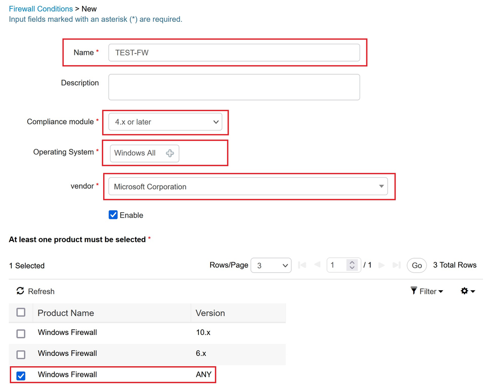

Create a condition for Firewall check, navigate to (1)Work Centers → (2)Posture → (3)Policy Elements → (4)Conditions → (5)Firewall Condition and press Add.
Click Submit to save the new condition.

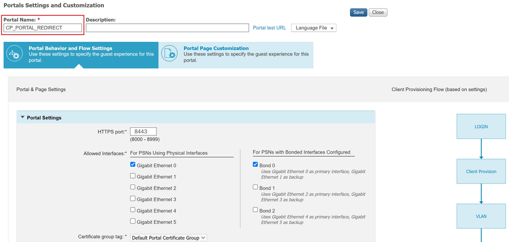

Navigate to (1)Work Centers → (2)Posture → (3)Client Provisioning → (4) Client Provisioning Portal. Create a Client Provisioning Portal named CP_PORTAL_REDIRECT.

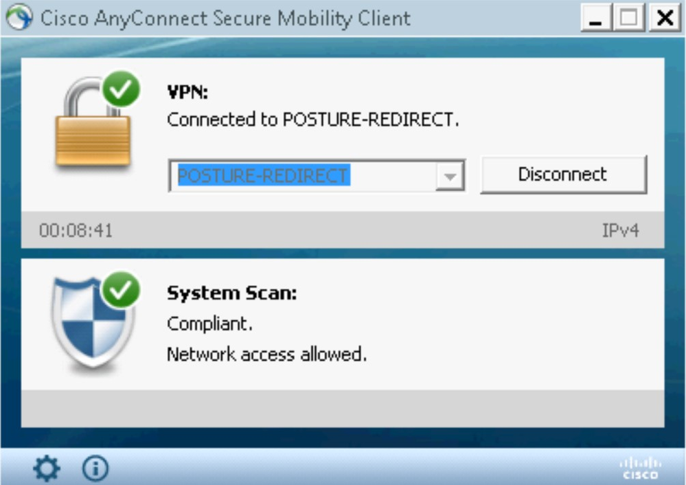

A warning indicates that the Firewall on the PC is not enabled.
On the PC, enable the Firewall Windows.
The user will gain access to the network with a Compliant status.
