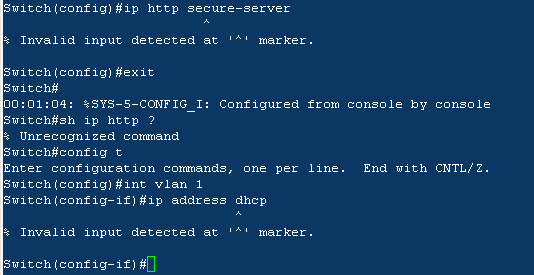

I am trying to configure interface vlan1 to get an ip address from dhcp by entering the commnad ip address dhcp
ios rejects the dhcp portion of my command as not recognised although it is referred to in Cisco manuals.
my IOS version is c2950-i6k2l2q4-mz.121-22.EA14.bin
I get the same problem when I try to configure ip http secure-server on the switch.
Can somebody inform me as to whether this is a known bug or whether I have the correct IOS version for these commands?

I can set an IP manually but I do not want that.
I do not remeber the options now and I do not have the switch in front of me. However what I DO NOT GET is the dhcp option.
I can enable ip http server but NOT ip http secure-server.
