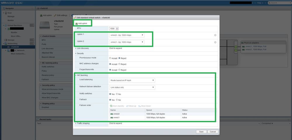

I have a BE6K C220, this server has a vmware esxi 6.5, and need to connect that with two cables as aggregation to trunk ports on the switch, how can I do that, what can I do on the vlan option on the esxi console and must check the two nic boxes? what is the configuration to do that on the web to pass more that vlan on the teaming cables? how to pass cimc, management IP on thses cable? Thanks

Here is how I have configured in my environment:
Switch Configuration:
vlan 105
 name IP_PHONES
vlan 107
 name UC_APPS
interface Port-channel14
 description ### PORT CHANNEL FOR CISCO-BE6K-01 ###
 switchport mode trunk
 switchport trunk allowed vlan all
 switchport nonegotiate
 spanning-tree portfast trunk
interface Port-channel15
 description ### PORT CHANNEL FOR CISCO-BE6K-02 ###
interface GigabitEthernet1/0/17
 description ### CONNECTED TO CISCO-BE6K-01 vmnic0 ###
 channel-group 14 mode on
interface GigabitEthernet1/0/18
 description ### CONNECTED TO CISCO-BE6K-01 vmnic1 ###
interface GigabitEthernet1/0/19
 description ### CONNECTED TO CISCO-BE6K-01 CIMC MGMT ###
 switchport access vlan 107
 switchport mode access
interface GigabitEthernet2/0/17
 description ### CONNECTED TO CISCO-BE6K-02 vmnic0 ###
 channel-group 15 mode on
interface GigabitEthernet2/0/18
 description ### CONNECTED TO CISCO-BE6K-02 vmnic1 ###
interface GigabitEthernet2/0/19
 description ### CONNECTED TO CISCO-BE6K-02 CIMC MGMT ###
In this configuration, CIMC port on BE6K is connected separately to the access port of the switch. All UC Applications and ESXi Management data is travelling over same trunk ports. If you have enough ports on your Hardware, you can separate this traffic.
ESXi Configuration:
1. In ESXi Administration, go to Networking >> Virtual Switches and update configuration settings for existing vSwitch0 or you can create new vSwitch. In this environment, I am using vSwitch0.
Capture_2.JPG 2. Click Edit settings >> Add uplink and update NIC Teaming settings.
3. Go to Port groups >> add port group. Define port group settings including VLAN ID. Most of the networking settings are inherited from vSwitch that you select. You can create multiple port groups with different VLAN ID's.
4. Associate Virtual Machines with the appropriate Port Group.
5. Test the network connectivity.
I hope this will help you.
Please rate helpful posts and if applicable mark "Accept as a Solution".
Thanks, Vaijanath S.

"When aggregating appliance interfaces, the switch ports to which they are connected must be configured to use 802.3ad link aggregation"
Source: https://www.cisco.com/c/en/us/td/docs/voice_ip_comm/cucm/BE6000/InstallationGuide/12_5/be6k_b_installation-guide-M5-1251/be6k_b_installation-guide-1251_appendix_0110.html#CUCM_RF_C5474FB9_00
I think you need to switch your mode from On to Passive.
Also, you correctly set your ESXi load balancing to IP based, but you didn't show in your switch config where you switch it to match, because the default I think is MAC based. Can you confirm what your load balancing is set to on the switch with this command: show port-channel load-balance

Thank for pointing out the channel-group mode. EtherChannel and IEEE 802.3ad standards are very similar and accomplish the same goal. There are a few differences between the two, other than EtherChannel is Cisco proprietary and 802.3ad is an open standard.
VMware ESXi supports both EtherChannel and IEEE 802.3ad. Here is the URL and configuration example:
https://kb.vmware.com/s/article/1004048
On the VMware side, ESXi 5.1, 5.5, 6.0 and 6.5 support LACP on vDS only and not on Standard Switch. I am using Standard Switch. Below article lists all the requirements for link aggregation for ESXi. One of the requirement is set link aggregation in static mode ON.
https://kb.vmware.com/s/article/1001938
I can't seem to find a flaw in your research, so my only conclusion is that cisco has bad documentation. Would you be willing to submit a documentation defect, or shall I?
