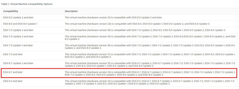

I've same issue. Cluster CUCM and IM&P 12.5 in ESXi 6.7. My customer wants to upgrade to 15. I was thinking of upgrading vmware to 8, and then upgrading the cluster to 15. In theory vmware 8 should support the hardware version of VM (even though Cisco does not support it). What do you think? What is the best procedure to follow?

Last question. ESXi 7U3 is only supported from CUCM 15 (from Virtualization for Cisco Unified Communications Manager Doc). 12.5 (in my case 12.5.1.10000-22) is only supported ESXi 6.5/6.7. What is the difference with 8? Because in terms of compatibility I don't see any differences. They are both not compatible (for Cisco). Maybe the transition from 6.7 to 8 is more complicated?
If 12.5 doesn’t support ESXi 7 then you’ll need to add an extra step to land on 14 in between. Or simply do a new installation of 15, with a data export/import to get the data from your 12.5 system.
