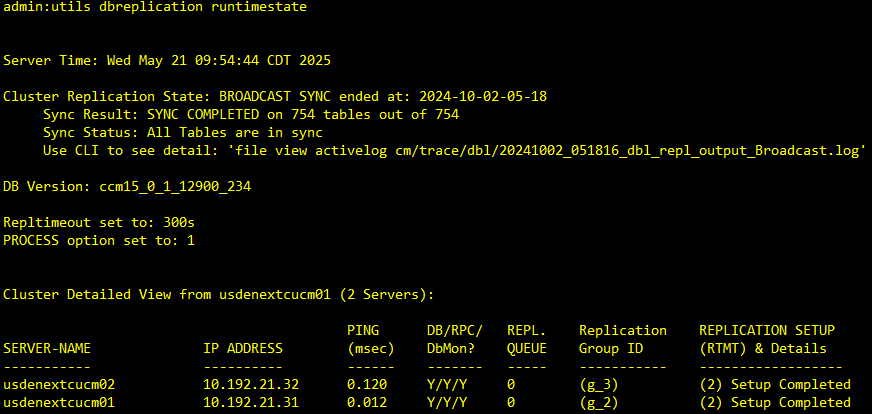

are all your PUB & SUB servers in same Vlan/Subnet ? or in different Vlan/Subnet ?
is there a Firewall between them ? (maybe something is blocking ICMP packet between them..)
did you test ping to each other servers using CLI command ? (utils network ping ...)
also, as dear @Roger Kallberg said, you must have an output like he is shared with us..
specially you must have "Y/Y/Y" for DB/RPC/DbMon section
and you must have "(2) setup completed" for Replication details section..

Run the following command to check the database replication status:
utils dbreplication status
Then, execute the following to get detailed runtime state information:
utils dbreplication runtimestate
The ping value represents the round-trip time (RTT) between servers. The maximum acceptable RTT is 80 milliseconds.
