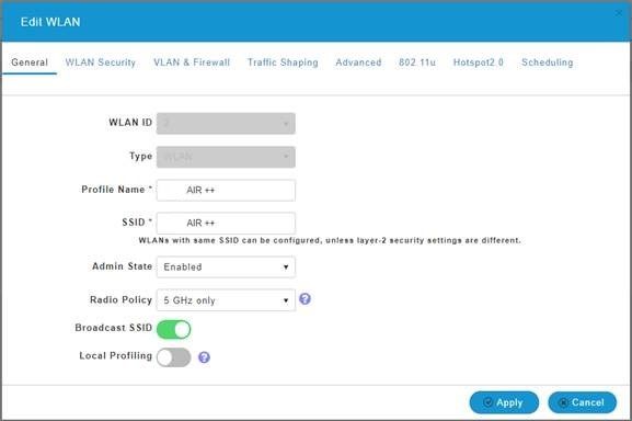

I join C1852 setup.
Cisco1.jpgCisco2.jpgCisco3.jpgCisco4.jpgCisco5.jpgCisco6.jpgCisco7.jpgCisco8.jpgCisco9.jpgCisco10.jpgCisco11.jpgCisco12.jpgCisco13.jpgCisco14.jpgCisco15.jpg
I try to change Best in 5Ghz Channel Width to 80Mhz to force it to be @80Mhz but it doesn't change anything.

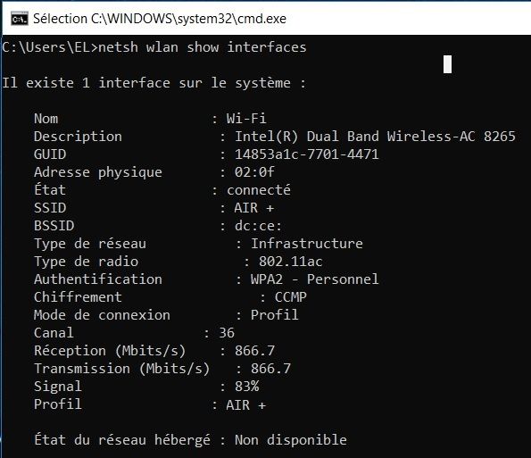

On windows, with "netsh wlan show interfaces" the NIC vendor/model is displayed and sometimes the antennas are included in the description.
As MTOMASSINI wrote, which exact adapter model is built into your Lenovo?

83% Signal is surprisingly bad and shows other signals in the area disturbing your signal. The Reception/Transmission rate are the previously mentioned "data rate", so you should reach a transmission speed of around 50-60% of that data rate with a >95% Signal quality.
So I would currently say, everything is more or less normal. Only things you can try, update the Intel driver to a newer version and make sure you don't have other APs near on channel 36+40+44+48 (if using 80 MHz channels).

The signal quality with netsh is not a reliable value (it is not related to a specific RSSI but only a Windows threshold).
