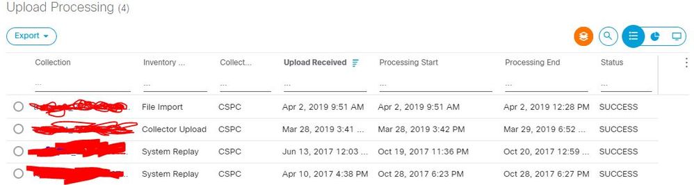

If so, as far as I am aware this would be a different collector registration than having an additional CSPC installed on your network (Example Collector2) and should be treated as separate instances. Can you send a screenshot of the CSPC upload that you have initiated that has been received by the portal as the image below?
If the status of the above is either 'Processing','Failed' or 'Bypassed' then your data will have not updated into the portal as of yet. however, if the status is 'success' then can you navigate to devices and see if the serial number is apparent for a known affected device?

I uploaded the .zip file exported from the collector. Both processes have the status of "success".
The upload done from the collector (03/29) does not display the equipment serial number information.
The file import made today, and already processed, shows all the information of all the equipment.
