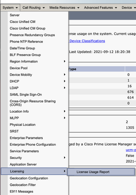

Could you share the screenshot of CUCM License usage report page. And PLM license usage report.
