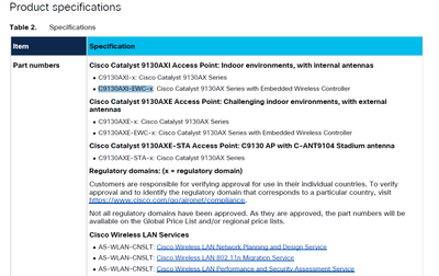

I got a couple of C9130AXI-B Access Points to build a small Wi-Fi network (2-3 Cisco APs). I thought it has the Embedded Wireless Controller as stated in the Data sheet for the 9130AX series or did I get the wrong part number and I should have bought C9130AXI-EWC-x?
I just need to get to the web management interface to configure the device. Is it possible to do without Wireless Controller (like is there web server running on the AP)? If not, what options do I have? Buy a separate Wireless Controller HW? Convert the AP to the EWC (https://www.cisco.com/c/en/us/support/docs/wireless/embedded-wireless-controller-on-catalyst-access-points/215303-embedded-wireless-controller-conversion.html) ?

 - The including screenshot is rather clear for what you should have chosen (when buying)  to get the EWC included ; there are no licenses needed for using EWC , you will have to resort to the conversion as mentioned in the link you posted if the AP is currently not running EWC ,
 M.
