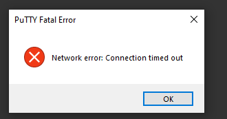

I'm not able to reach the switch management IP from my PC. Switch 2, however, is reachable and I can ping it from my PC. I'm using Putty, the error that I get is the following:

   >... If I try to access it via SSH directly, it doesn't even give me a login prompt.
                        How far do you get then ? (and or post a screenshot (e.g.))

what IP you use in PC ? what is IP of managment VLAN ?
I think that direct not work because the IP of PC is different subnet than the management VLAN IP.
when you access via other SW success because the SW1 management VLAN IP is in same subnet of SW2 management VLAN IP
