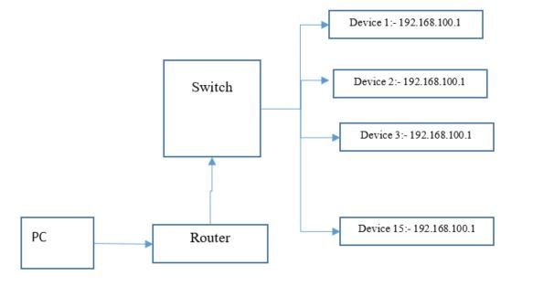

Hi everyone ,
i am quite new . I have been stuck up from quite few days . i have to implement a solution for the below requirement .
1) i have 15 devices  with same ip address ( ip address is hard coded inside and can not e changed ).
2) each device need to communicate with a PC.
3)  device don't need to communicate with themselves. they just need to communicate with PC.
4) we are allowed configure PC to Static or dhcp ip .
How to achieve this  ? any kind  of  recommendation  would be very helpful
-> also  i was already  looking at nat solution but not sure which switch would be able to perform this job.
 -> also not sure which architecture would be good    without  router or with router Capture1.JPGCapture2.JPG

this is bit strange situation. i have few clarifications,
1 - how your application identifies each device separately if using same IP? (may be that is not a concern)
2 - what is the IP address of communicating common PC? is it in same network?
Good luck
KB
Hi ,
The customer devices have same ip.
What they want is to either recognise the device using the switch port to which it device is connected or to generate a maksing ip which can be used in place of device ip to connect to a device .
2) The pc is on the same network and we are free to select any ip static or dynamic to it.
hi,
Update 1 -
normally, you cannot duplicate L3 connectivity with IP addresses unless you use NAT. in this case you can use NAT for each device. this is only suggestion.
you need separate router's for each devices and create Virtual NAT range (different networks which are not available on your network) for each device.
connect all routers to 1 another router and do correct routing. in this case you need to have different IP range for main PC too. if you need to have same range with devices, you can do another virtual NAT in main router too.
this is possible technically, but not feasible for non branch network
Update 2-
also you may be able to use VRF with 1 router. needs some good guidance. because i am not very good in VRF :)
Good luck
KB
Hi kasun... thanks for the help . I was also thinking to go with vrf . But i also not so good at it .
Nat capable l3 switches arequite expensive . Any suggestion is there any switch which can do the natting
Deepak Kumar
Are those devices offering the same services? If one device is getting the update will sync with all devices same like a database?
Only VRF is also not looking a good solution if all of the devices offering identical services and there is no sync between all devices. Because whenever PC will reply to the IP address then routing protocol, CEF, or ARP will take a decision and it may load balance or reply to the single system only.
You may archive your goal with NATing + VRF. Let me test in the lab and will come back.
Regards,
Deepak Kumar
Regards,
Deepak Kumar,
Don't forget to vote and accept the solution if this comment will help you!

Hello Deepak,
I am looking for a support to have similar setup with more than 40 devices ( Scada PLC) having same IP and need to access from outside. I hope we may use a router which have 48 Port to do both NAT and VRF. Appreciate your advsie...
